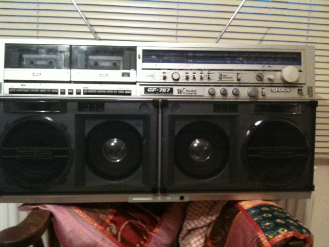

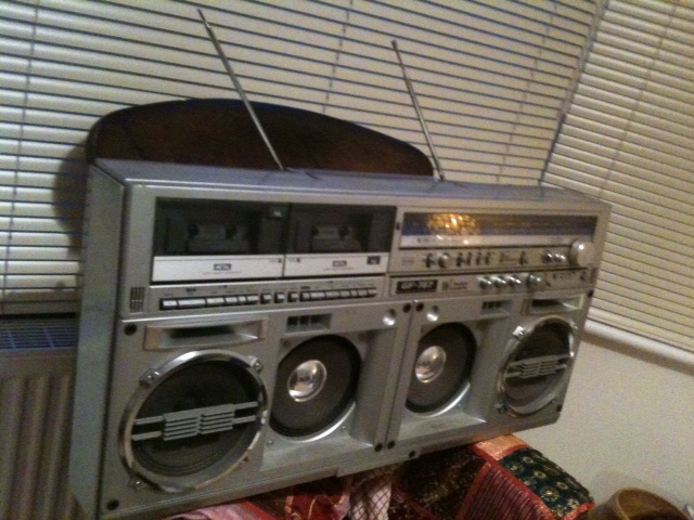

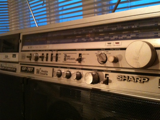

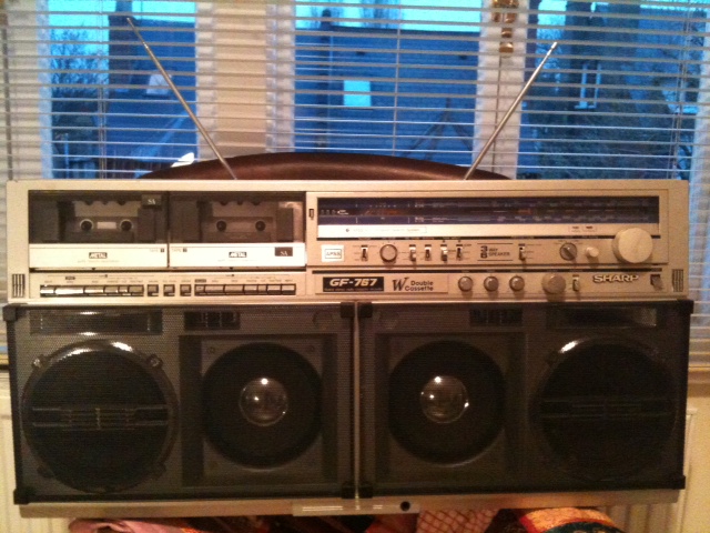

I have just bought my second purchase of a Sharp GF 767 in cosmetically good shape except for one end antenna Knob was broken off and 3 of the switches all the same ie the dubbing and both tape select switch knobs are missing.
But the main and vital problem is that after being stored in a shed for 15 years it no longer starts up. no power.
The seller assures me that it worked when he stored it away, and he was very genuine.
Can anyone pleas advise me on the best cost effective steps I should take before taking it to a technician?
