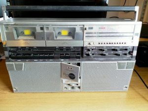

My latest purchase arrived today: a Sharp GF-555E, picked up for £50 on eBay.
It's generally in reasonable shape, the biggest problems being...
Tape decks working in fast forward only
All slider controls crackly

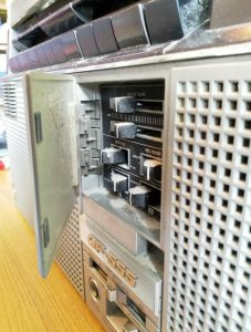

Recording control door doesn't stay closed and sags on hinge
Small piece of metal trim missing on left of cassette door

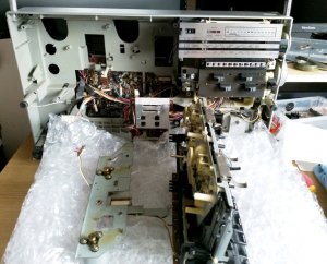

... which made getting the casing open very straightforward.

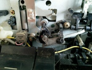

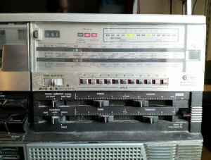

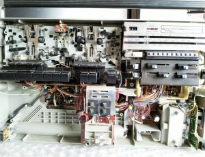

First job was to get some contact cleaner into all the sliders and switches. That made a huge difference to just about every control. No more crackling and every slider now moves easily and smoothly.
The tape deck issues seem to be a result of the take-up spindles being driven by a friction roller from the capstan; the rubber on both capstans having deteriorated into a sort of black slime. There was also a foot or so of tape wrapped up in Deck 1, a previous victim of the failed take-up drive!
The information posted by jimmyjimmy19702010 here:
http://boomboxery.com/forum/index.php/topic/24631-sharp-gf-555-restoration/
... proved invaluable, so Jimmy, if you happen to read this, many thanks!
I've cleaned all the black slime out and ordered some 2mm ID/5mm OD tubing, once that arrives I'll reassemble the decks and see how well it works.
The rest of the deck mechanisms seem fine, even the pinch rollers and belts are intact and in decent condition.
The door will be more awkward, I'm thinking of using some slim neodymium magnets to hold the door closed, provided that I can install them unobtrusively. If I can find them in suitable sizes, I'll glue a pair behind the casing and another pair in place of the rubber pads on the door.
The missing trim should be easy enough to replace, as long as I can get hold of a suitably thin piece of aluminium. It'll just need brushing with a wire wheel to give a similar finish to the rest of the trim, cutting to size, and gluing in place.
Beyond that it's just a matter of giving the whole thing a good clean. I've done a few small test areas and it looks like it'll come up quite nicely. The sticker on the door has of course been removed ("ablemesh accepted here", what's that all about?).

The silicone tubing I ordered arrived in the post today, so I was finally able to reassemble the GF-555.

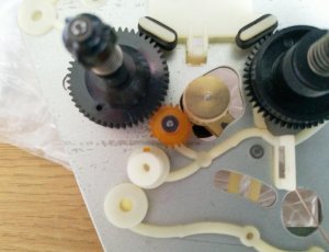

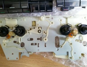

There was a lot of gooey decomposed rubber on the idler tyres as well, so before fitting the tubing to the capstans I dismantled the mech further to clean those tyres thoroughly. They cleaned up well, but I did notice another problem whilst the deck was in bits: the rewind idler gear on deck 1 (orangey coloured one in the pics) has several teeth missing. So, for now at least, I only have rewind on deck 2. Any suggestions as to where I might be able to buy a replacement gear?
Reassembly was relatively easy, although it's a fiddly job to replace the flat drive belts. The silicone tubing on the capstans has worked beautifully. Other than the rewind on deck 1, both tape decks are now fully functional. Even the APSS feature works, although in fast forward only due to that damaged rewind gear.

geoffhartwell
i have one of those gears, i pulled it out from a junker 555 deck for a member here last week , but he no longer wants it, its yours if you want it, just pay shipping cost
jonny
That's a very kind offer Geoff, thank you very much! Will certainly take you up on that. Fire me a PM and we can sort out the details.
