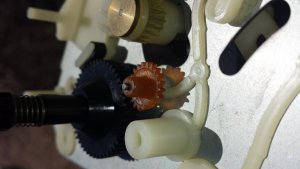

I was rebelting this deck and after getting everything back together I noticed there was no rewind. After pulling everything everything apart I found the gears are broken. Anyone know where to find a replacement?

Whereabouts are you located Josh? If Geoff doesn't have the parts, I have a couple of junk 555s which will have what you need.
Josh9994
I found the gears on ebay from a seller in UK that are 3d printed. It took 1 week for delivery. I just got them installed. They needed the center hole drilled and a little bit of sanding to fit. The gears are about 2x as thick as stock so they should last a long while!
