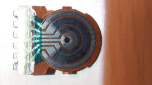

Here Is a picture of the volume potentiometer, any one know where to find one?

After a while of trying to locate replacement pots, I managed to repair the damaged pots using a silver epoxy, I also used some carbon glue.
It took a good number of hours with the ohm meter and using the oven set to 215° F to speed up the epoxy cure time. The results although not pretty are good enough for getting this box up and running!

Good job, done a few of these and layering the conducting paint is key to get the resistance thereabouts.
