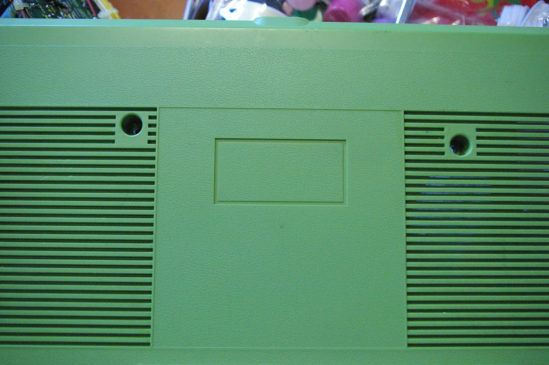

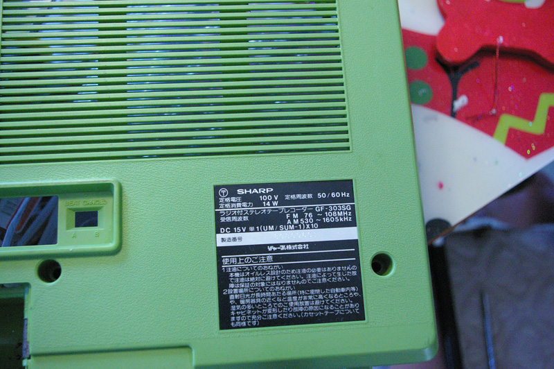

I started with the top faceplate. Although the front and back case parts are really dirty, the top faceplate was dirty to infinity and beyond. I loaded up the sink with very hot water and added some Dawn liquid detergent. I let the piece soak for a couple of minutes and then started wiping. This is the first time I have tried using Dawn to clean boomboxes and I must say that I am quite pleased. The grease and grime wiped off fairly easily. You don't even want to know what color the water was after the cleaning.
Anyway, here are the first pics of the GF-303SG restoration:
BEFORE:
AFTER:

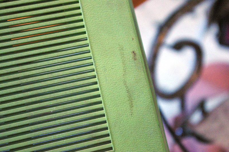

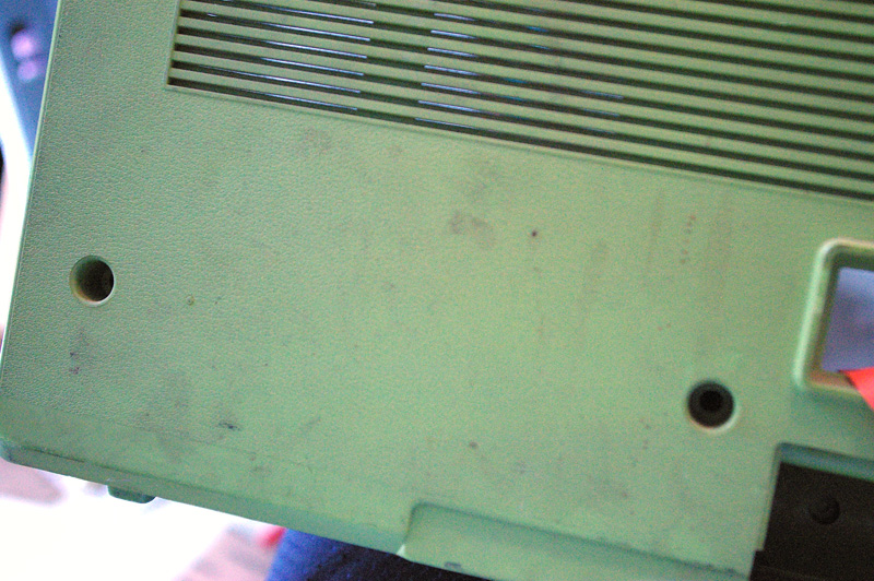

Okay, I finally got the back half of the case clean. :-) Damn, whatever was on the top was much easier to clean than the crap that was staining the back. :-/ I started with the hot water and Dawn again and got a good amount of the grime cleaned off. However, when I dried it to survey what was left, it still looked as bad (to me) as it did before the cleaning. Damn it! :thumbsdown: :annoyed:
I pulled out some of Paula's special blend for carpet cleaning and even that was a "no go." :sadno: I tried my trusty ol' Orange Glo, which is known to work wonders when cleaning boomboxes, and even OG couldn't tackle the nastiness that remained. :huh: :huh: It was almost like the grime had actually bonded with the plastic because it wasn't coming off at all.

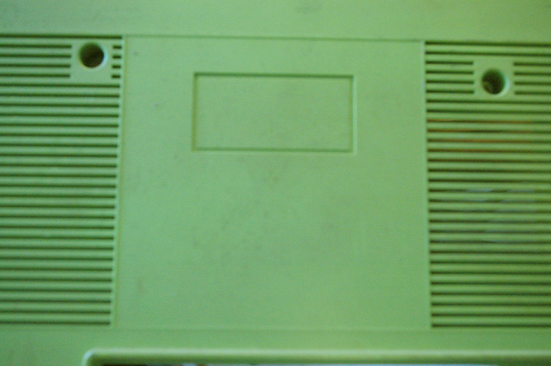

I quickly fired up Google for a last ditch effort to try and clean the back case. I found an article referring to cleaning plastic lawn chairs and it was suggested to use a mix of baking soda and water - 1 gallon of water and 1 cup of baking soda. The article also stated that you could apply baking soda directly (for tough stains) and use just enough water to make a paste. So, that's what I did.
I want you to know those farkin' stains didn't stand a chance!! :w00t: :w00t: :cool: :thumbsup: :thumbsup: :breakdance: :-D :-) I was totally flabbergasted and elated at the same time! Wow! This stuff really works.
Anyway, enough of the jibber jabber. Here are the pics:
BEFORE:
AFTER:
