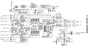

So I got the Toshiba, tape doesn't work, no surprise, but no radio either. Aux works fine though so if I had to guess from the block diagram it might be the TA7614AP chip as I get no tuning light, no sound, no static, just a low hum when turned up.
Any ideas?
