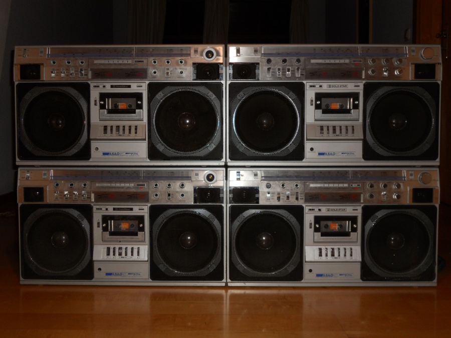

But I have some of this Monsters:
They sound way better then a 9191. :yes:
