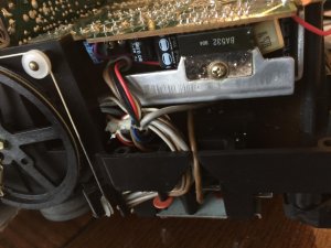

The connector I had issue was mounted on the boards. Female connector was on the amp board and male on the tuner. The rest were all flexible connectors and ribbon wires.
This hum could be from some ground lead malfunction. That is a general statement!
James, you know better!
I would check the leads of the chip that is connected to the heat sink, and that area of the board.
