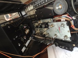

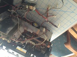

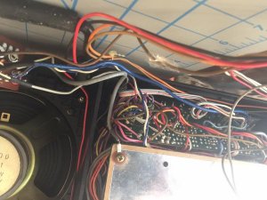

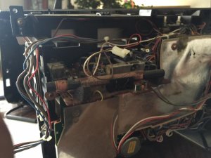

I have some pictures that I took yesterday but put the box all together after dexoit treatment.
