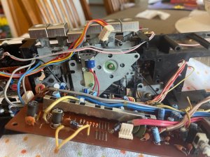

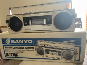

The tape was playing a little slow and I replaced the main belt with SCX 9.5 and it played so well. When I tried to rewind the button got stuck and will not release now.
I spend half a day to replace belt and all and now my big disappointment is that rew button will not disengage. Even though the door is locked I can still open up the unit.
I was wondering how to solve the issue.
Dec 3, 2010
5,763
276
Chicago, IL
After so much pain and suffering I figured out it has to do with the belt tension. The idler pulley moves too much to lock the rewind mechanism.
Another Sanyo with belt tension that interfere with the transport mechanism.
Reactions: Hisrudeness
Dec 3, 2010
5,763
276
Chicago, IL

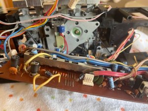

I was so disappointed last night and put it all back in the place and thought I cannot fix this. Today, after catching up with work I thought let me get back to this box and somehow fix it. It was a struggle to get to the flywheel and all without some desoldering. However, I could get the main PCB away from the tape section by moving the board in the right direction and unplugging all connections to the PCB. There was no need to desolder anything.
The old belt was almost 10.5" in length, and I put one at ~10.00" from my assorted belt collection. Everything works like a charm now.
Deoxit all the switches, record bar, lubed the capstan with synthetic oil, greased the metal moving levers in the tape transport section, demagnetized the head and cleaned the pinch roller. Everything including recording works so good.
This is one of the best sounding minis I've got in my collection. Stereo wide is Awesome so also the radio reception. It got a 4-band radio and only downfall is it has no treble and bass control. Overall, it is a super nice mini box to have.
I feel so glad I fixed it all.

Royce, be careful using belts from those variety packs for more than temporary testing, they are generally poor quality and don't last very long before they start to stretch or degrade.
Hi Eric,
Thank you! I will find the belt with the correct measurement later and replace it.

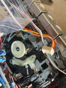

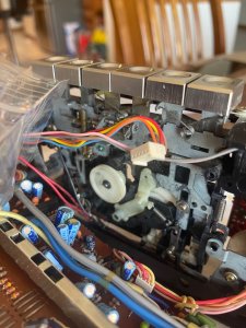

Idler wheels are all plastic gears, and no rubber contact wheels in this deck. Flywheel has a gear under sitting on a spring and that is in contact with the drive mechanism.
