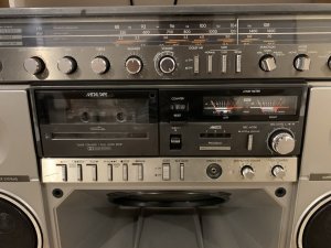

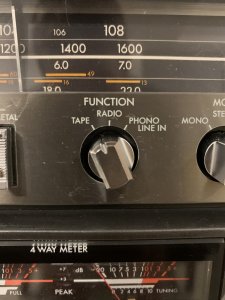

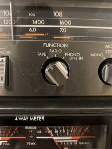

My volume is fine for radio and line-in/phono functions however I have very faint volume from only 1 channel during tape playback. At first I thought it might be the cassette head however now I’m thinking it’s not. I was able to get a slight increase in volume and the other channel working when I turned the function knob slightly clockwise towards the radio selection between radio and tape (as shown in last photo). I have already sprayed the pot for the function selector. I sprayed it a bunch and turned the dial clockwise and counterclockwise. I completed spray the record bar and moved it back and forth, completing both staying and moving in many occasions. This didn’t seem to help anything. Do you think I may need to resolder some connection between the function switch and the tape volume? Also, I the little lights next to the play and pause button aren’t functioning neither is the VU meter during tape playback. Is there any info that would help me get the volume/speakers working during tape playback?

I feel it’s the function switch. It has a weird, more indistinct click from “radio” to “tape” that seems different than when I click from “radio” to “line-in/phono.”
I’ve sprayed it and sprayed it, moved it and moved it. Anything else I can look at or do?

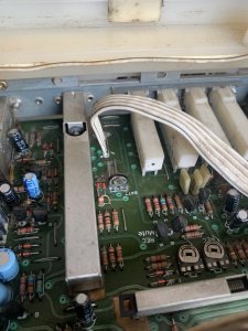

Post a picture you may have to remove from the PCB
i removed the 2 front screws but was unable to get it off.

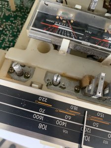

So I spray a silicone lubricant only inside the top hole and only a little amount. That freed it up and now the function selection “clicks” normally when the dial is moved from radio to tape. This however did nothing to change the issue with the significantly low volume.

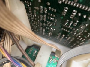

i looked at the bottom of the circuit board under the function switch and it has many solder points.
I really wouldn’t know where to start. It’s a shame I can’t get the tape volume squared away. I thought it was a bad head but after hearing the volume increase slightly with the function dial between radio and tape, I don’t believe it’s the head. If the function bar is manually moved or the record pressed, there is a loud brief noise since volume is turned up to 10.

Is it that long silver one? You will have to remove from the PCB I use solder remover wick. Once removed there are metal tabs that can be bent to release the metal cover gaining access to the tiny slide contacts. Clean up with fine wet and dry sand paper including the inside of the contacts. Then use silicone grease to protect the contacts. Then reassemble exactly as found.
The hardest part it removing from the PCB, I have done this many times and is very rewarding although not on this box.
