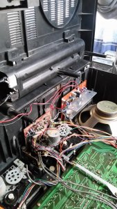

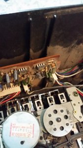

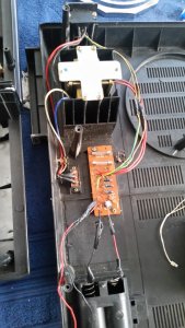

HI, I been working on my rexcel but unfortunately I came to a stop because some of the wires have been cut off and cassette deck needs belts .. any idea for belt sizes?. By the way I am k dabras . Lost my account. 20220108_185830.jpg20220110_144800.jpg20220108_170807.jpg

You can use dental floss to make a mock up belt. Or just buy a bag or random belts and find ones that fit.

Joint the old belt with some glue or whatever way you think. You will come to know the exact belt size. make sure the new belt is not too tight or loose. If it is loose type, it makes your cassette to slip during play. If that is too tight, it may work fine now but it will damage the pully needle after some time.
