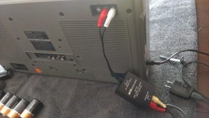

Another question, What kind of input does these holes do?
Can those to work with Aux with the right cabels?
Beosystem10
Not directly, no, they're higher in sensitivity than an aux input. The separate earth clamp beside them is a clue to their being Moving Magnet cartridge inputs for playing records from a connected turntable but don't despair; devices are available that apply the appropriate eq curve and reduce the output from the higher line level signal so that you could then connect your mp3 player, CD player or whatever.
Search the forum for "Attenuator", that'll throw up plenty of information about what's needed. :-)
k2j
Yep, MCM has cheap phono attenuators and they work pretty darn good for the price!

Alex the great
Checked the MCM store out and found a fitting phono attenuator, 8 dollars seems really be worth the monney.
Still waiting on answers from mcm about shipping costs tho, sinse i live in sweden.
