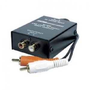

I tried to play my mp3 files from my mp3 player so I plugged it in the phono line in (it's a RC M 70 L so no real line in, just phono) and the resuly is that the sound is soooo loud it can't play, I mean even at volume one it's way too loud and distorted
How come? Do I have to use a special adapter before I plug it into bbox phono in?

Its a phono attenuator and it steps down the input level to a phono level so that it comes through nice and clear with no distortion. I've got several from MCM as shown, they cost about £10, and work very well :-)

thanks a lot !! I think I saw it on a youtube JVC RC M 70 boombox video but wasn't sure!! just found it on ebay uk for 17€
