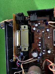

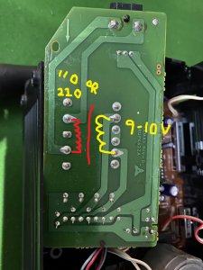

where do I begin? Something that would fit, but what else am I looking for? Number of pins, what they are etc
I think it transforms to 9v.
Help appreciated.

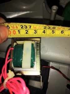

How much room do you have. I stumbled across this cheap radio with a low profile single tap transformer. 35mm

Looks like roughly 40mm deep and 70mm wide.
Trying the one linked above on ebay but if no joy with that i'll be interested in this for sure.

Hard to find low profile. Also the right output current I would say the one I pictured is only 1a 9v. Yours may need 1.5 or 2a? Who plays it at full volume anyway haha.
