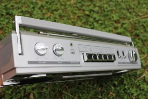

Last week I got my old Palladium "micro boombox" back! She is in rather good condition, with only few bumps and bruises, and rather clean for a radio from 1985.

Oh, yes sir, no problem. I am going to pretend that she is ready to rock in my back yard, on D-cells. :rock:
