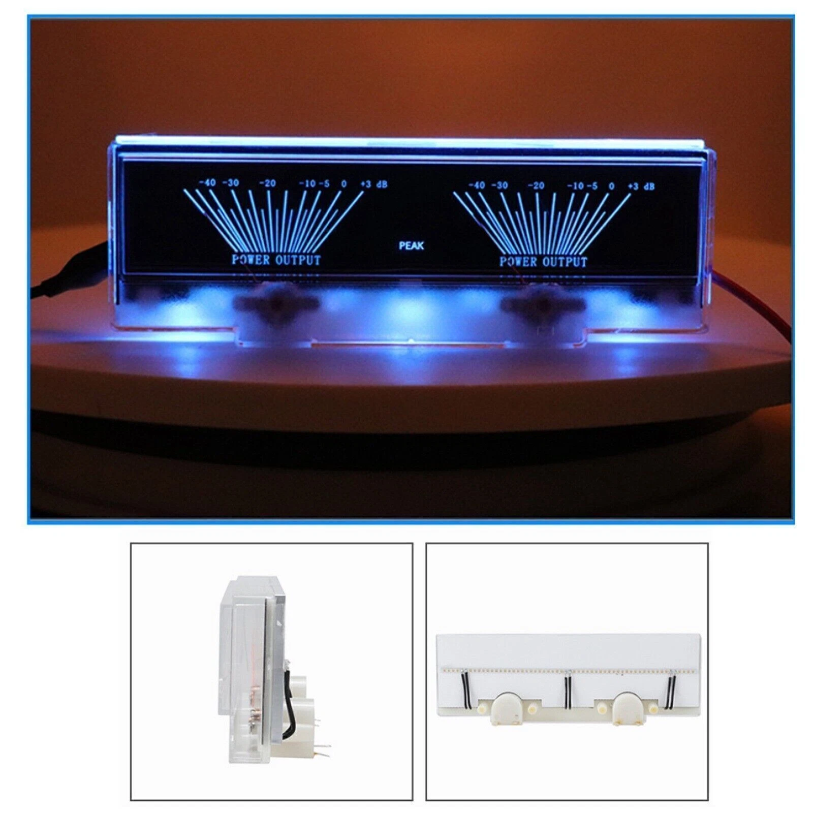

Thanks a million. I saw these on ebay. Figured they would be the closest match. They are certainly on my radar
It sucks they're not white but they were all I could find at the time.
They're a good length and seemed to move correctly.
Unfortunately, I'm sure the price on them has gone up considerably since I bought them.
I remember the guy I sold that box to contacted me a couple of times over the next several months to tell me how much he was enjoying it.
It still bothered me that they were orange.
Maybe the white Sharpie paint pen would work like BoxBeats said in my linked thread.
