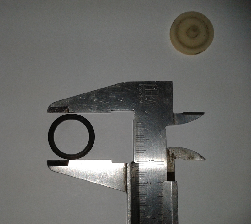

devol-toni
Here it is the exactly size of the idler tire for GF9191/9494/9595 (I'm not sure if it is the same dimensions for the 9696 because I haven't that model)
Outer diameter: 22,0 to 22,5 mm
Inside diameter: 16,5 mm
thickness: 2 mm
I hope this will help and good luck with finding the right replacement :-)

Ghettoboom767
It has a chunk that fell off of it.Got really brittle and old. :sad:
I might do some measuring myself when I put the new rubber tube on
the capstan this weekend.I think the tire in this photo is from a 9191
or 9292 in which case is a little smaller in diameter.
I'll keep all informed after I do this. :-)

Hi Jeff,
If you cannot get idler tires there is another option.
:-D
Go to a plumbing shops like Menards, Home Depot, Lowes and and look for O rings. Pepboys also got these O-Ring Assortment.
You will find one that fits the plastic wheel. For GF9696 this might cause speed variation but it got a motor speed adjustment. at the lower left slde of the cassette door and you can adjust the speed. :yes: :yes:
http://www.homedepot.com/p/DANCO-O-Ring ... 444?N=c4aw
The diameter of the idler tire and the tube over the capstan both influence the speed of the tape in play mode. With the motor speed adustment slider we can compensate for it.
Ghettoboom767
Well thanks to Royce I got my Sharp GF-9696Z
tape deck fully working right now!! The larger of
the 2 O-Rings was a perfect fit for my idler tire!! :thumbsup:
