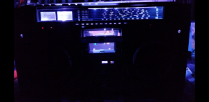

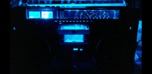

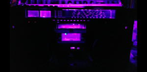

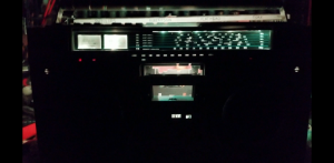

Now for my next question. Where can I tap into a good 12v source on this box? I have an led light kit setup which looks amazing. But during radio playing I get interference from the transformer that came with the led kit.
