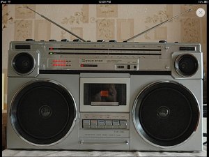

my new bbox is a minty Gold Star TSR 580, in full working order except the FF and REW doesn't hold on
do I have to change belts? where do i find them, is it hard?!
help please!!
I'll post pics tomorrow
Thanks anyone

hello yes it has autostop and it works well be it play or ff or rew but I don't think the pause button has anything to do with the problem
sometimes it will rewind or fast forward for 10 seconds then suddenly stops and the buttons won't lock down in position... I don't really bother since the play function works flawlessly but it would be nice to fix it anyway thanks for your answers, I will keep it like this for the moment

yes that's it, buttons don't lock down in position or just for a few seconds that's strange but seems only mechanical

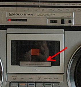

Was not saying that the pause button is the problem. All I wanted was for you to try REW and FF with the pause button pressed in and engaged and if REW and FF forward worked fine with the pause button engaged then the problem could be the auto stop stopping the REW or FF prematurely. Hey just try it. :-D
I have black knobs on my GOLDSTAR TSR 580. I think the model with chrome knobs also comes with a digital clock to right of the tape counter. :bow:
I still don't think the goldstar has full auto stop. If it says "autostop" only then only play/record will stop. If it says "full auto stop". Then all will automatically stop. I agree with auto stop being gummed up because I've seen many decks that were gummed up <br /><br />As for issue with FF and Rew not locking down you may also want to check lock down itself. Could be bad spring or gummed up.
