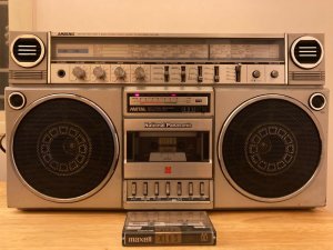

I own a National Panasonic RX-5150 since 1982 (pic attached). However from past few months I have a few issues & I need some help from folks here.

1) Tape works fine, but after some time the tape slows down a bit (momentarily) and comes back after a while. This happens quite often.
- I have got it serviced with a known guy & he states that the head & pinch roller are perfectly fine & the motor might be an issue.
- New belts have been replaced.
2) When I switch on, the power LED comes up without any issue. However when I play the tapes rest of the LED lights does not function (including the LED for the TPS)
3) My TPS function has stopped working, though it is not a major problem but I would like to get that working too.
This might be a overkill but, I don't mind replacing pinch rollers, head, quality belts & the motor (whatever the cost maybe). The reason is, I have great deal of sentiments connected with this boombox which was given to me by my father who is no more. So I wish this stay with me in & functions completely.

You can service the existing motor which may fix some issues. The belts maybe to tight.
