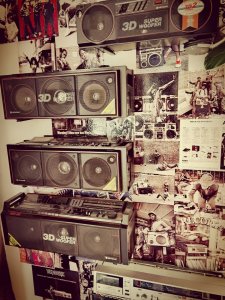

If you need help, just let me know. Good luck with this nice machine!
