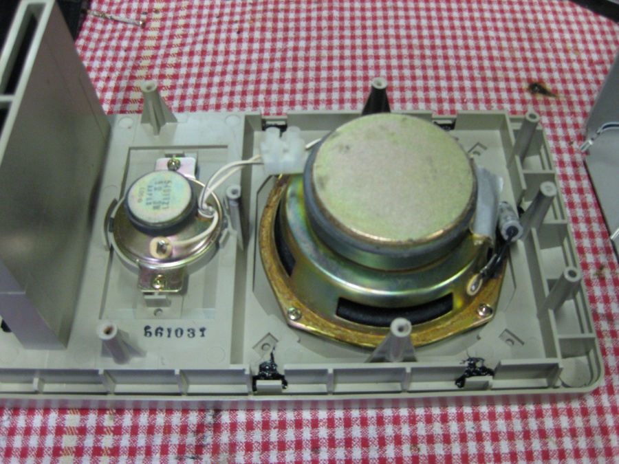

Below are a few photos showing the huge driver magnets and the thickness of the speaker casings.

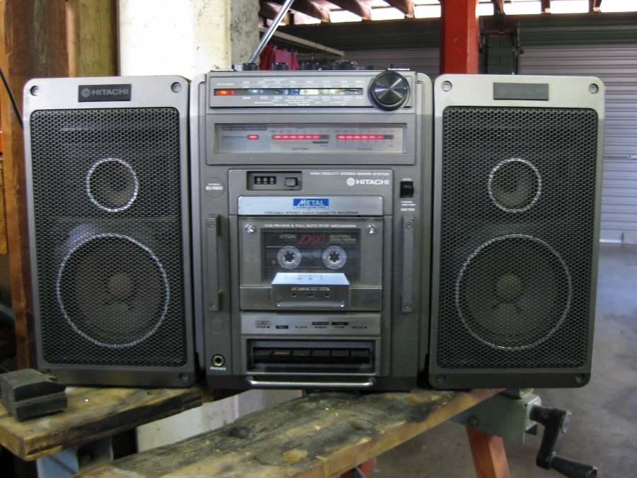

Photo of the 9140E after the speaker swap: now that's better!
I've seen smaller magnets on 8 inch speakers!
Non original, faulty and ugly old drivers & a tweeter missing its' dust cap: Be gone!!
Super thick plastic casing:

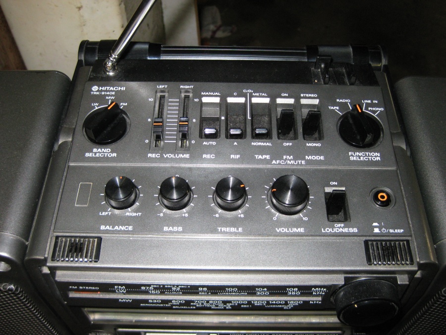

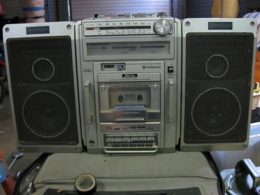

Defeatured dash board of the TRK-9200W:
I know she's no beauty but she has got it where it counts!!

Jimmy, do you have pics of the 9200 speakers you put into your 9140?
I own a 9140, and its speakers are Foster 3.2 ohm woofers and Foster 8 ohm tweeters.
I know they're original because I was the first person to crack these screws.
The sound quality sucks --- no bass :thumbsdown:
Hi Reli,
All of the 9140, 9150, 9200 drivers I've seen have looked identical: 3.2 ohm: Made in Japan.
Your drivers and tweeters look different. All of the 'Japanese made' drivers I've seen have a paper surround and tend to last.
From memory, the cap for the tweeter should be attached to the driver - I'd check to make sure the tweeter has a cap in circuit somewhere. Also, I've never seen that new looking foam in any Hitachi box. The Hitachi padding I've seen is a felt material. The piece of foam beside the tweeter looks like it might be blocking the bass port. Remove that piece and try it again.
For a giggle a while back, I tried blocking the bass port on my 9150W for a test - the result was zero bass!
If your amps are healthy, the bass and treble performance should be very strong. I'm talking big 1 piece beating bass.
I dunno, maybe Hitchi in the late 70s used brand name Taiwanese drivers and tweeters for a production run?!
There are blue caps, you can see them in this pic. Honestly the sound is mostly mids and mid-bass. Nothing deep, nothing very high. Also, this one was sold in Germany and it doesn't have a separate Loudness switch (the Loudness is supposedly integrated into the Volume circuit), so maybe that's part of the reason.
What do the drivers look like from the front? I bet that foam was blocking the port. The felt padding normally only surrounds the driver. No padding extends up the tweeter / port end of the speaker box.
I've also never seen that green goop used on the speaker screws before.
Why would a manufacturer make a bass port and then deliberately block it with foam?
