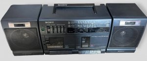

I bought a Sony CFS W370S from ebay a while ago. It was sold as spares. 'NO POWER' was the issue.

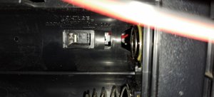

When I got round to testing the box I tried batteries and it worked. Then, after I took the batteries out, I saw the voltage switch in the back was set to 110volts. I switched it over to 240volts and tried it. Nothing. The internal fuse had blown. I swapped it and SUCCESS.
