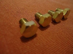

R these them? Seem reasonable enough to me!
Not 100% sure, but pretty sure not. Those are very course threads and a heavier bolt for holding their 70's receiver and amp face plates on. I do have a 1250 that needs a couple tho.
Had I known about this Marantz box I would have never tossed those decks without checking here 1st for matching parts. :bang: That unit looks exactly like the SR 4000 I have and that era's (early 80's) decks styling.

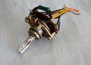

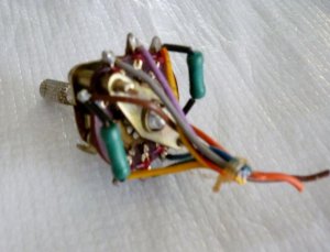

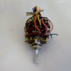

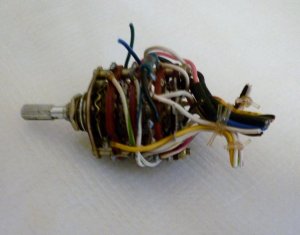

So. Took the item to tech. Got the VU meter unstuck. But not receiving signal to work. The selector, I hoped was a simple deoxit fix. Tech believes it may be cracked, which is why I have to keep flickering it to contact both channels. So this turns out to be a donkey kick to the bag. Here is another selector, to give you an idea of the horrid it would be to replace it. http://www.ebay.com/itm/Vintage-Marantz-2215B-Receiver-Part-Selector-Control-Switch-/191689302597?hash=item2ca192a245 looks like I may have a parts unit. fark!!selector 1.JPG
It's all doable if you have the patience. I would never write off a box because of one switch fault. Getting a replacement part will be the hard bit though. :-(
Good luck,
James..... :-)
riker1068
I was thinking perhaps a similar marantz selector would work. Considering maybe even putting a multi toggle switch in the back of the box to operate. Or just hold it on the top shelf until switch swap. Or sell it as mint. Lol

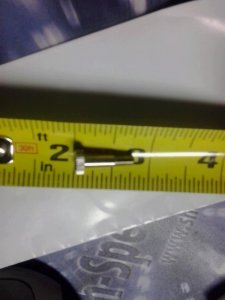

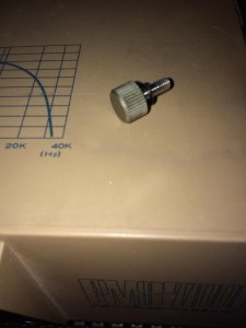

Came across another Marantz deck (SD4000) today and although this looks a tad different than the pic you posted, here is what I got. The shaft dia is exacty 1/8" on the threads and just a hair over on the shaft barrel.
Sorry for fuzzy shot tho, taken at shop,crappy light.
