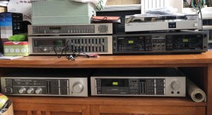

Eric (Caution) purchased this from his local goodwill along with a bunch of other stereo stuff to part out and I inquired about it because it looked like it was complete and in too good shape to be parting out. I forget but I think I merely said something along the lines of "I like the dual deck pioneer." Never in my wildest dreams did I expect Eric to ship it to me. Anyhow, it's found a new home. The color is a bit different but the style is similar to my other Pioneer set. Thanks Eric!

Transistorized said:
How does it sound? Any repairs needed to get her up and running?
It didn't work. Neither deck. Looking on eBay, its seems none of the Pioneer decks of this vintage offered are working either so apparently, the age of these decks have now all eclipsed their belts life expectancy. I did spend about 4-5 hours working on it and yep, the belts are all gone the way of the la brea tar pits. And if any of you ever worked on a "real" tape deck before, not a "boombox" tape deck, you know that it's a whole lot more involved. Anyhow, I got new belts in them except for the counter belts. The left deck works good now and sounds great. The right deck is doing the chipmunk and it's because the pinch roller is not contacting the needle, almost like it's in pause mode but it's not. So I've got to go back in and see what is up and why it's doing that. A bigger pinch roller probably will get it working again but of course that's not addressing whatever is the cause that is blocking the pinch roller from going all the way up. Anyhow, these are great decks and very well built. When it's all restored, it will be a lot of time expended but worth the effort and will be very satisfying. It's about 90% there. Just waiting for my back to get back to normal so I can work on stuff again. Tweaked it a couple weeks ago and I just can't do much right now.

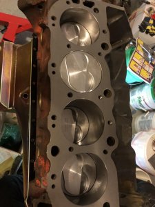

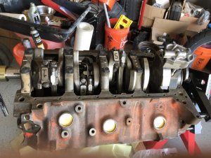

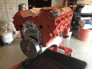

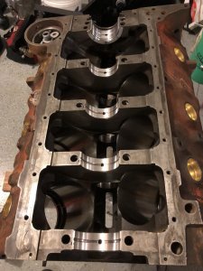

Pics of the Pioneers stack and the Big Block Chevy please :-D :yes:
blu_fuz said:
Screw the Pioneer, more BBC info.
neanderthal said:
Pics of the big block Chevy?
Well, if you guys insist, but just a reminder, this is a BOOMBOX forum, not a car forum. I'm still working on it and taking my sweet time. Without a body to put it into, there simply is no rush. Anyone have a fun body for this motor to call home?

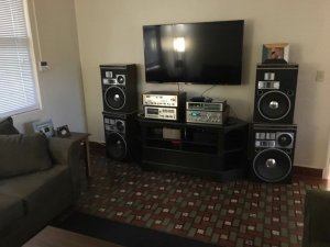

As for pictures of the stack and the set lit up like Christmas Tree......
Well, unfortunately, I've had guests visit me from California, in a row, and moved stuff around the house. The entire stack is disconnected to make room and I haven't had the time to set them back up yet. Also never took photos before. Maybe later when everything is all set back up, I can have everything powered up along with the newly restored Caution pioneer deck too.

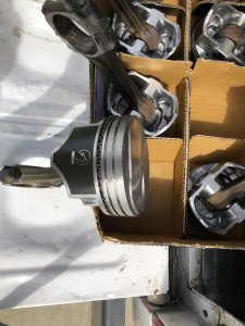

Speed Pro forged pistons to :drool: :drool: :drool: :drool:
