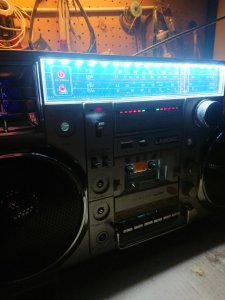

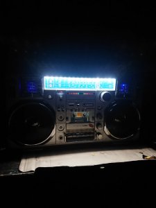

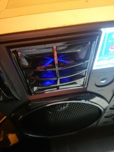

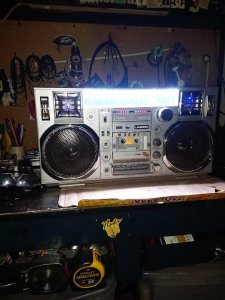

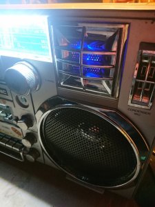

Changed worn floppy belts , Deck wouldn`t lock in . Pressing play, ff , rew, pause, no lock. Ultra grime and sludge between plates like molasses in January. Cleaned it using 99 rubbing alcohol and qtips , relubed , head cleaning, azimuth adjustment . Had to remove 4 solder points and 7 screws to be able to access deck. Lasonic may have skimped on exterior build quality , but their electronics , point to point hand soldering similar to 1970`s stereo receivers, impressive. The sound is raw, and in my opinion rivals the sound the m70 puts out, the 920 with double the output wattage. This 920 grinds and plenty of bling to go around.The M70 @ 7 watts rms per channel , the 920 , 15 watts rms per channel. Anyways, here`s a few pics from today`s project. Leds installed as per request.

Cool LED's, the tuner on these is begging to be lit up.

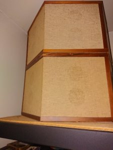

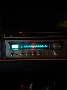

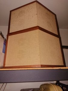

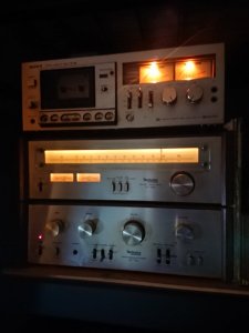

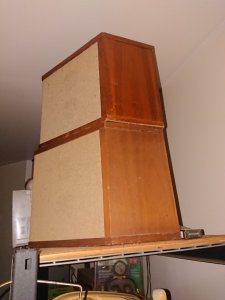

I have 2 sets of pentron 5`s here. They were made for Brack Audio in Toronto in 1968, 500 pairs known, manufactured by a fledgling company that later became Altec Lansing. Took me 7 years to get the second set. The rear firing long throw 10 inch woofer has a rubber surround , the 4 midrange/tweeters are alnico reverse wound. The wattage? 30 watts rms. The idea here was that these were created for the Marantz low power line to prove they could shake the corridors. I have 2 systems in my garage , one a Hitachi SR-502 receiver, the other, a Technics Amp SU-7100 . The sound output even at low volume doesn`t miss a bass note. When turned up, the Hitachi has the edge on the Technics in bass department. When you crank them , the speakers break up a bit with a beautiful muddied sound, yet clarity remains. Yes, they shake the house. The walnut wood definitely accentuates the sound.Guess that`s why i like the raw sound of the Lasonic 920. Here is a few pics of the systems, and the Pentrons.
