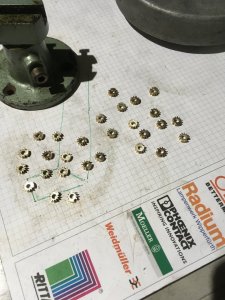

Trommelmops' milled brass replacement gears to the rescue. I LOVE this kit, I got two gears and it comes with a milled tool for tightening the tiny bolt that attaches it. Beautifully engineered.

Trommelmops again. You need to file down the ends of the original metal shafts with a file. They were attached under pressure and that gives them a lip that needs to be removed before you can fit the new brass gears on
