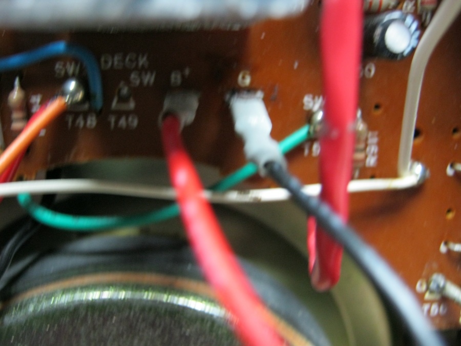

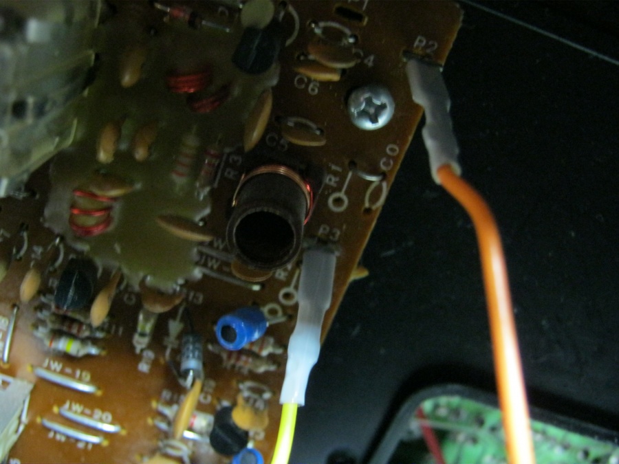

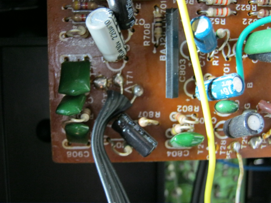

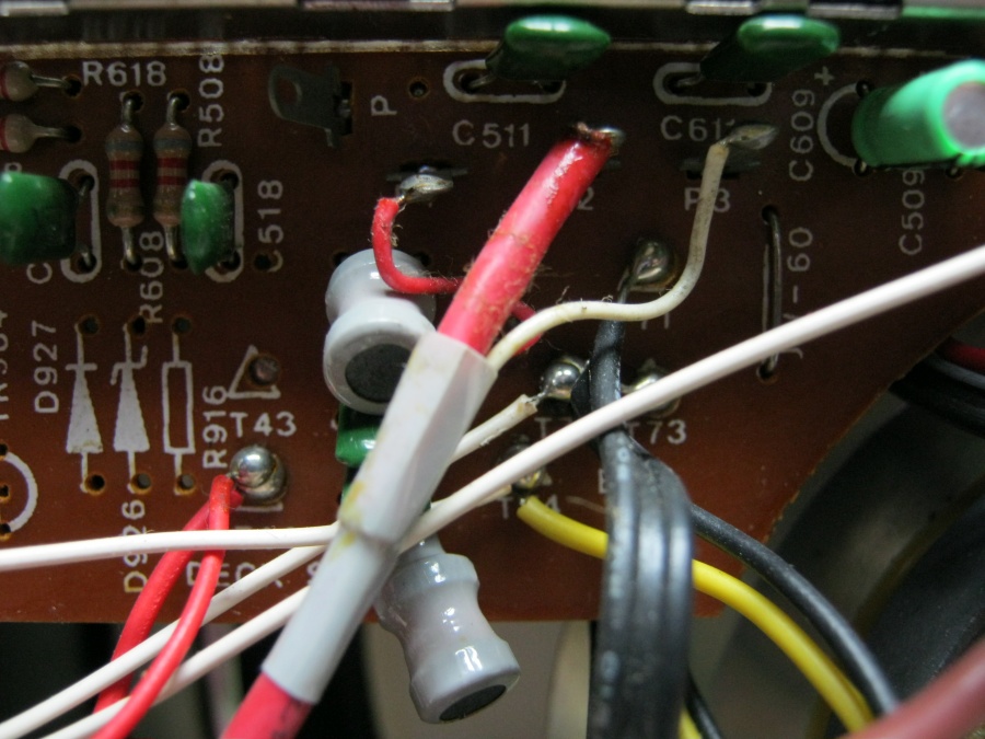

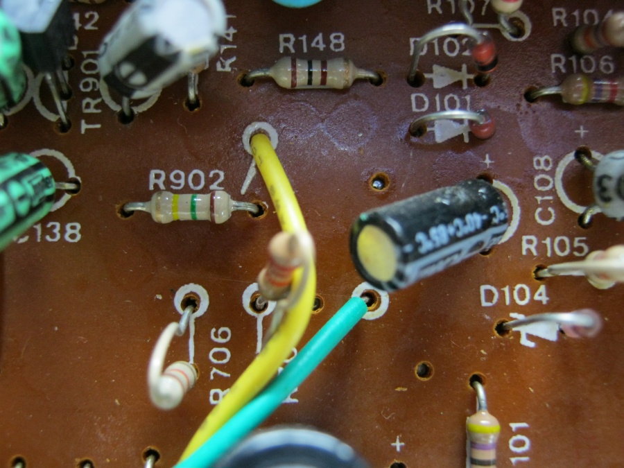

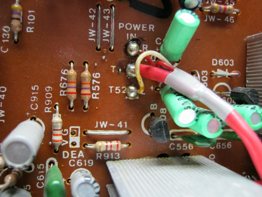

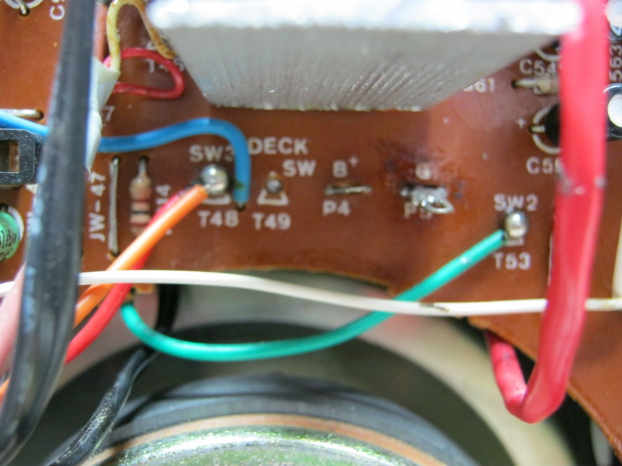

I received a Lasonic TRC-931 today and it sounded like the UPS man kicked it to the front door. Plugged it in, pushed power and nothing... shocker! I opened it up and it didn't look as bad as it sounded, a couple broken pieces and some loose wires. I'm hoping you guys can help me get this thing up and running again! here we GO!

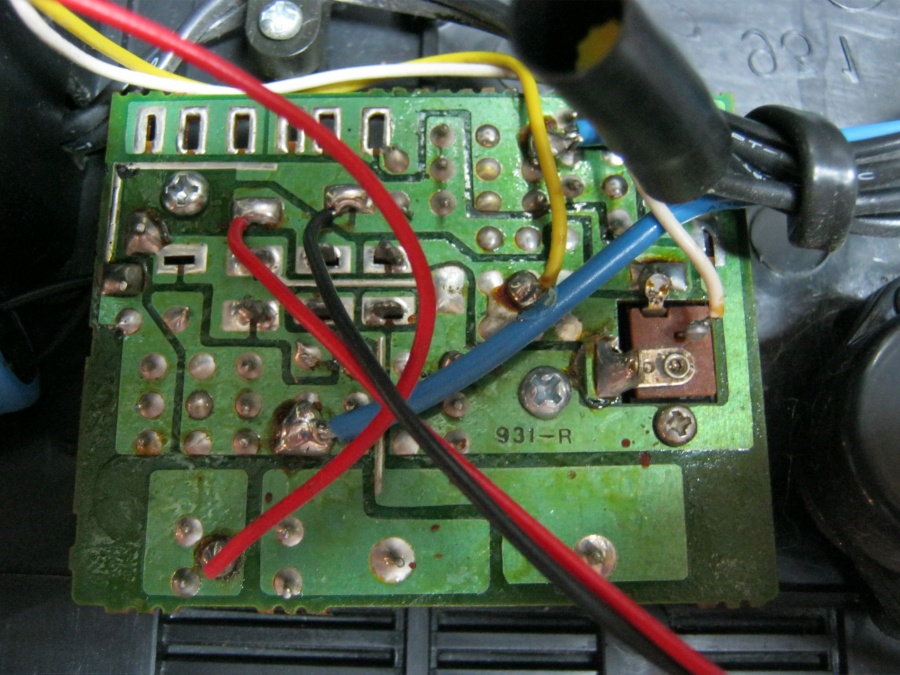

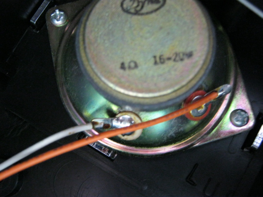

Looks like transformer board has break in corner. If you know how to solder than easy fix. As for deck wire they need to be rue soldered as well. Like Joe said you never plug in damaged box til you look it over :yes:
solder gun is ready to go!! so where do I start :huh:
Here is how the deck wire goes back on three prongs sticking out. Arrows in red

baddboybill said:
Not 100% sure if this needs to be done but it won't hurt.
Definately do that with thick wire. plus super glue the board back into shape. also, what component is on the otherside of the board (piece) and where does it lead to? That component may be broken as well. Flip it over and look
k2j said:
Probably no component on other side looking at all the joints being attached. Maybe wires :hmmm:
Looking at it it's probably diodes but I doubt it's damaged. Just solder wire to two points and make sure no more loose wires then test. The blue wire off transformer that was off is why it didn't power up ;-)
