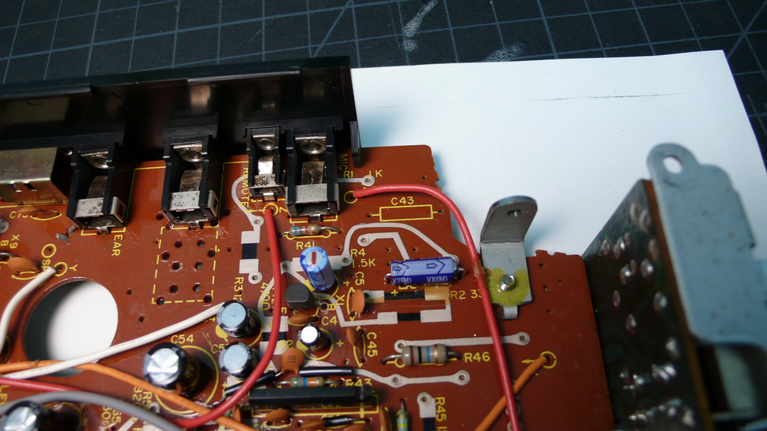

To keep my “idle hands” busy I opted for a full recap of the main board.....

Talking about typos and caps polarity, C43 is a good example (top-right corner). All of a sudden, its polarity is not marked on the board (this is why you need a lot of photos from "before" or SM even for simple recap) and its number in the SM is C143, not C43
