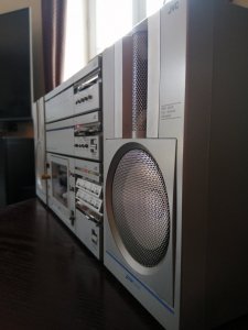

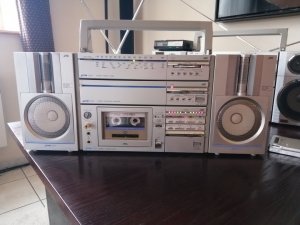

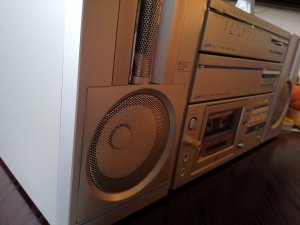

Hello,
I recently acquired a jvc pc-5, with only 2 issues :
Stereo reception hardly working and main problem : someone had replaced the speakers / drivers.
After having seen nick Eccles replacing them with jbl and trying those I wasn't quite happy with the sound, nor with the 4 ohms.
So I went for a loooooong search and trials and errors... From pioneer, sharp, jvc, jbl, Sony (from an fh-7),.. And others until found a pair that combines both looks and sound : fostex fe103-nv.

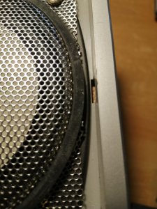

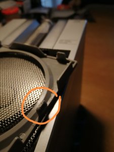

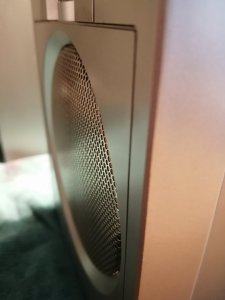

They are an almost perfect fit without changing / modifying the speaker cabinet. The slight backdrop : the square enclosure doesn't close on the sides (the two little lips on the side can't enter due to the frame of the drivers being less. Than half a mm too wide, does blocking the little lip thing that can't be squeezed in. It's hardly noticeable...
Sound wise... Damn this device blows! Pretty deep bass and great highs and mediums, even Alan Walkers Faded and others now play with bass.
