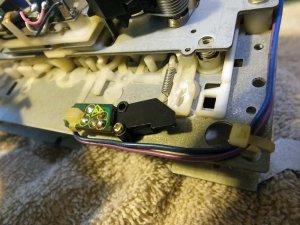

I was rebelting and re-pinch rolling today and found somewhat broken switch behind the right deck FF button (buttons assembly removed on the picture), looks missing the pusher and broken to me!
