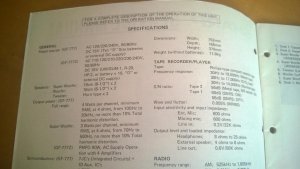

Is the GF777 really this weaksauce?
Here's the specs in the service manual. The power output seems really low.....
4 watts per channel for the outers, and 3 watts per channel for the subs......For a total of only 14 watts at 10% distortion? Hell, an M70 puts out that much. :-/
Maybe just a tad more but it does sound about right. Keep in mind that unlike some of the higher power boomboxes that uses 2 amps per channel in bridged mode, the 777 uses only 1 amp in single ended mode per channel.
