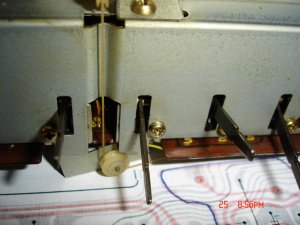

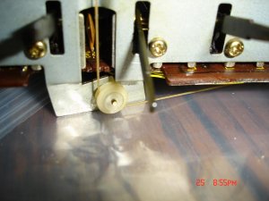

It is very common for the corner of the board on the left side to crack and and kill the left VU meter function. I had that issue with one of my 5350.
The second picture shows the crack. I used signal tracer and found the problem.
But no sound from the left channel and left VU meter not functioning could be related to signal loss due to another problem.
I would say check tape head and wiring for issues with left channel on deck🤔. Or function switch
