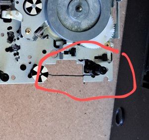

Hey boomboxery people. I've done some rattling around on the web for a service manual for the Sharp wq-t484. I've come up dry. I don't normally ask for help, but here we are.
There is a spring loose on the back plate of the cassette mech. I can't work out where it sits. It'sthe black return spring in the photo20240118_121308.jpg. Is it broken?
Hope you can help.

It is spring 72 but hard to figure out where it goes. :blink: May be where the green arrow points.... Hard to figure out unless you see it. Look for a section that is loose on an axle with a loop to catch, in the proximity of the spring. The green arrow pointed portion don't look like a section that is spring assisted.

Thanks for that. I spent a good few hours taking the mechanism to bits. Having had a good examination I realised the orientation of the spring on the schematic is in the relaxed state. It actually points to the right and butts up against the cam profiles of gear 22.

It's a complicated mechanism. I've fitted new belts and cleaned every part I can. So now ffwd and rew work on both 'decks'. But it wont play. The solenoid clicks and the motor spins but none of the gears move.

The solenoid usually engages something so that the mode gear can turn and its cams lift the head assembly. Can you tell if the solenoid is engaging any mechanisms when it clicks on?

The motor runs for a short while after the solenoid clicks, but it's not moving the heads.
Like caution pointed out the solenoid when it activates, has to engage some part on the gear and lift the head assembly. Manually raise the head and see what all sections are involved in that movement. See what is hanging around the mode gear and learn how it facilitate the movement of the play head mechanism. Do you see a missing arm/follower that engage with the gear and the head assembly movement? It has to be a cam and follower mechanism. We have to find the follower here, or both and how it is connected to the solenoid. I understand it is easy to say all this and in reality, it is very hard to locate all this.

So after 6 hours I've tried a few different thing. Having stripped the mechanism down to the gears and re-built it 4 times I know a bit more about it. It's still doing the same thing. The solenoid moves the followers across the cam (there are two followers), but the cam is not turning when the motor runs. Therefore the head lifting part of the mechanism doesn't engage. If i reach in and spin the cam a tiny amount then press play the heads lift into place and drop again.
