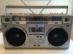

First box, a one owner M70, excellent cosmetic condition, only needing a couple new amplifier transistors. After weeks of ebay watching I actually found this posted on my local craigslist, and while it wasnt exactly a deal, I'm more than happy with the price paid (including repair) while I bump my decade old "wake-up show" cassettes.

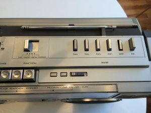

Thanks for the welcome! Will post pics soon, in the meantime, one channel seems to be off in tape mode only. Any suggestions?

That is a CLEAN and priceless M70. :jawdrop:
One channel not working on tape could be as simple as a record switch or tape/radio/line in/ phono function switch cleaning. :yes:
Try this.
Move that tape/line in/radio/phono switch couple of times and bring it back to tape. You should hear from both channels.
Don't be in a hurry to fix it all! Relax. If there is a member living in your area who knows how to work on M70 that would be the best choice.
Treasure that M70. It is so hard to find one in that clean condition. :thumbsup:
