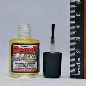

Just done a read around of all things m9990 and m9994 and found your great restoration account. I'm also cleaning the micro leaf contacts as i go - you talk of using a preservative on them after sanding. Can i ask what that stuff is exactly? curious
Thanks Superduper
