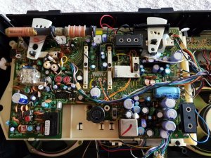

I have just got this machine an was wondering how you change the tape speed as it's running a little slow.
I have managed on others boomboxes no problem.
This has me stumped as I have read the manual inside out at least 10 times.
here is a picture of mine the inside picture is from the web as it's a good quality photo .
Any help would be very kind as I have managed to get it 95% working and just a few things to try and solve

Speed adjustment on the PCB is rare. The 5280 has no such thing.
Your motor is tied directly to main DC. Look at the snapshot from the service manual below.
Belts can have an outsized impact on speed, so make sure your replacement belts aren't too loose or too tight.
If that doesn't work, consider replacing the motor with one that has a speed adjustment.
Just make sure it has the same speed, rotational direction and power requirements.
Wes125
THIS MODEL HAS A centrifugal fixed speed motor. AS IT SPINS THE INNER CLUTCH OPENS UP AND ADJUST ITS OWN SPEED. THEY CAN BE ADJUSTED BUT IT'S A FIDDLY JOB AND MOST OF THE TIME YOU CANT GET THE SPEED RIGHT AND IT PLAYS UNSTABLE. AND THEY CAN SHORT OUT AND BLOW THE POWER SUPPLY FUSE.. I DON'T BOTHER WITH THEM. I JUST REPLACE IT WITH A POT SPEED ADJUSTMENT MOTOR
