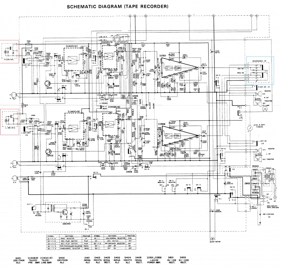

I demagnetized the heads but the crackling did´nt go awyay, so the problem is´nt the heads,assuming I did a well-performed demagnetization. Maybe this schematic could tell wether the heads are involved in the head output signal at all,
I marked the inner mics with a red square and the phone output with a bue square, I cant seem to find the heads among that mess :-O , but maybe someone a little bit more familiar with these kind of schematics could spot them?
Maybe this schematic could also give an final answer to the easiest or best way to get rid of the motor sound as heard in the wav file here,
https://soundcloud.com/hitachi-trk5280e/trk-5280-mono1
HERE IS A BIGGER VERSION OF THE SCHEMATIC DIAGRAM
http://homerecording.com/bbs/attachment ... 1361441042
