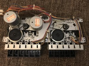

I would recommend to buy a set of 50 or 80 belts that can be easily found cheap on ebay.
As you can see on the picture you need 2 smaller and 2 larger belts.
Bluetooth is possible without changing to much. The unit has already a line-in port.
Batteries: I won't change anything and buy good D-cells like 10000mAH from Ansmann or similar.
