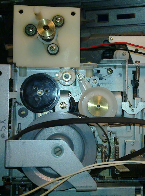

I need help :sadno:. I'm trying to install new belts to my TRK-8190e. I don't know how the belts should go. Can someone help me?
Maybe pics will help;:
Thanks!
The thin square belt goes over the black and white wheel and the flat belt goes over the motor and large silver wheel. After you install them you should clean with rubbing alcohol then use a belt n drive non slip liquid :thumbsup:

For some reason rewind and ff still slips and playback speed is not correct .(
I have new belts installed.
Are you sure it doesn't use 3 belts? It's hard to tell from the angular shot of the pulley planes.
I bet you didn't put the small belt around the silver metal wheel also ;-) And I noticed you have melted rubber on deck you should also clean it off with alcohol even the wheels :-D

I'm from Germany...I have the same Problem with my TRK-8190W. Have you fixed the Belt-problem?
Are there 2 or 3 belts to replace? Any picture how they go???
