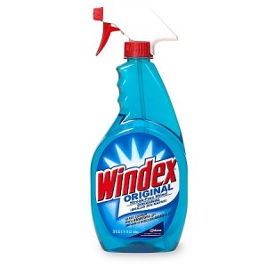

Hisrudeness said:
Windex is some sort of window cleaner I assume?
It is a very common glass cleaner in US market.
I believe it contains Butyl Cellosolve, Isopropanol, blue dye and water.

Hisrudeness
This might be more agreeable than the alcohol that I normally have to use.
I agree that the black goo is truly awful stuff! A little of it seems to go everywhere!!
