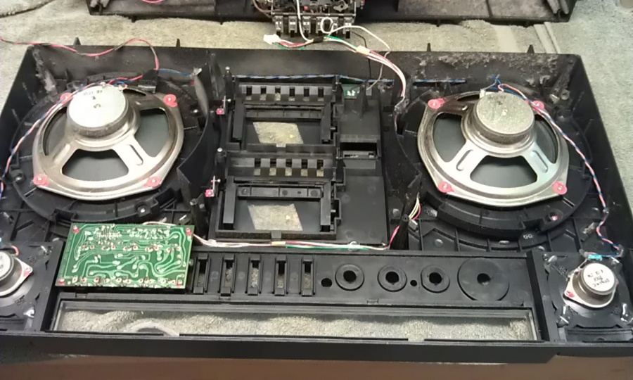

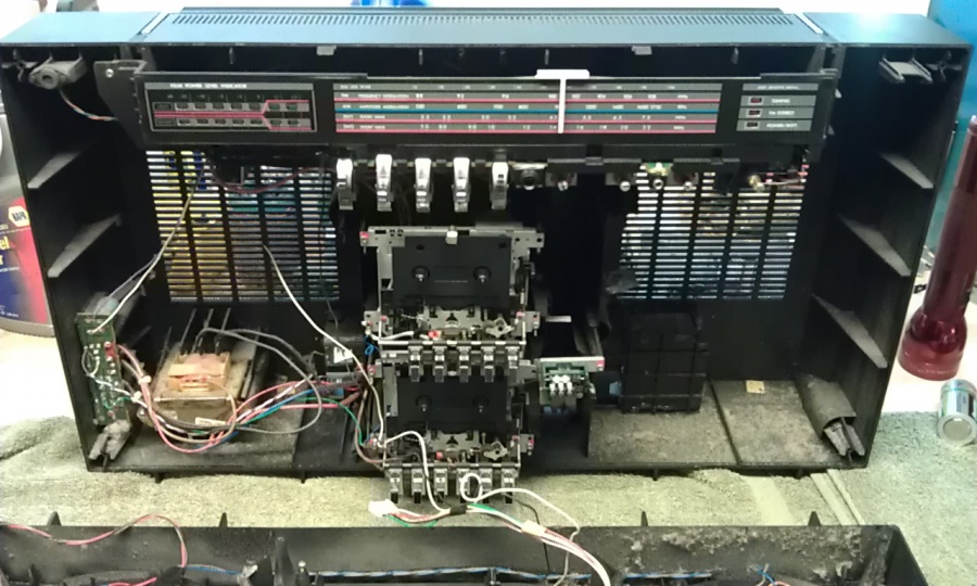

BTW, this box is SO well designed :yes: There is a tiny "S" near every screw you need to remove on the back. Pull the front knobs and the face pulls away, then 2 plugs inside releases the whole font panel clean. The EQ remains on the face with all the sliders in place. The cassette decks each come out with no fuss and four screws...and there's the belts :yes: :-D

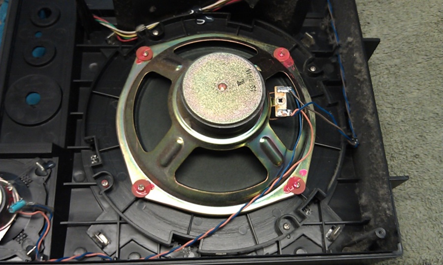

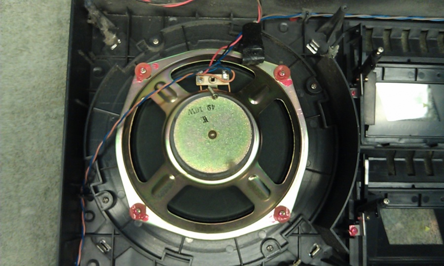

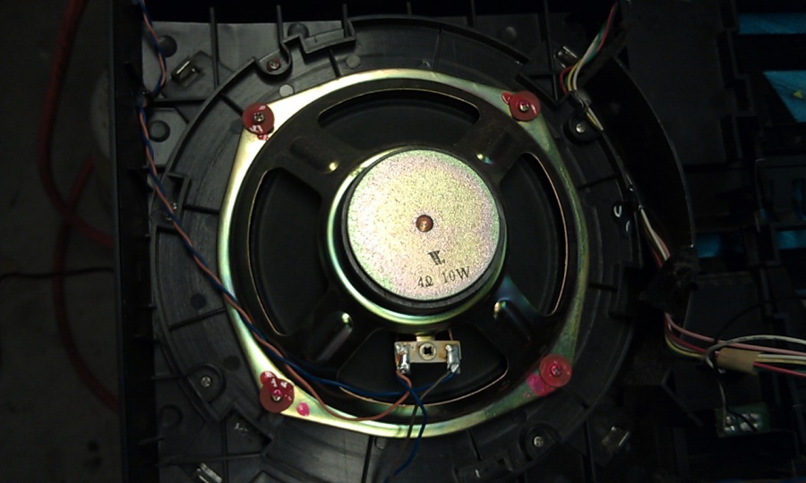

Although this radio "Appears" to have 8 inch drivers, it does not. I knew this and when you see it up close it it obvious...
BUT, inside the speaker actually mounts to a removable RING. You can unscrew the speaker from the ring and the ring from the cabinet face and then you can SCREW AN 8 INCH DRIVER IN PLACE :w00t: :w00t: :w00t: :yes:

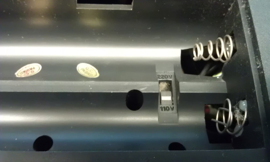

BTW, I found where the 220v/110v switch is....in the battery compartment...Good for you Euro guys! (OZ too?)

4 ohm 10watts, shouldn't be hard to find some suitable replacements... :hmmm:
