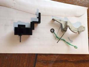

I changed the hard pinch roller on my 9696 and replaced it with a new one.
I did it by taking apart the two white levers one bu one out to reach for the black pinch roller assembly.
I used a metal tie on the spring clip / lock this time not to lose it and look all over the room on my knees. I was lucky! I didn't lose any unidentified flying parts. :-D
I could easily push the pin out and put a new roller.

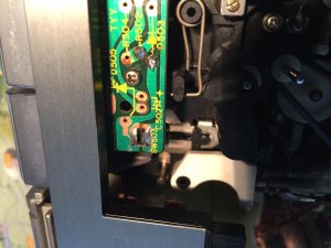

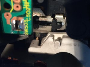

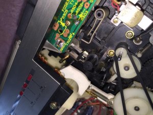

The last pic shows the second white plastic part assembly I only pulled the top part from the white axle and lift a bit to slide the black pinch roller assembly out. After putting the pinch roller assembly back. I had to pull this same white plastic part assembly slightly up to get to fit it to the axle.

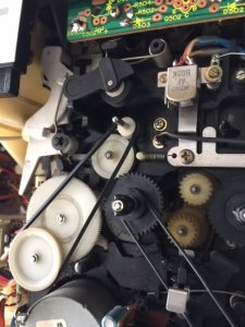

The slow running FFWD and rew is a fault I've never seen in a 9696 deck with new belts. Is the tyre that runs on the underside of the flywheel engaging properly? I I know you have to move the white lever the tyre attaches to to allow the flywheel to fully seat.
The FFWD and rew mechanism is just plastic gears so a dislodged or slipping tyre has to be the cause. I think the auto stop issue maybe related.
I'd check that tyre and see how it is running against the underside of the flywheel first.

ok i pulled mine out and had a play
the top white one is on a pin that connects to the selodoid (sorry how do you call it ) on the back
in your photo bottom of the top white arm seems to far from the bottom big cog
is it on the pin at the top properly

The main wheel tire for the FF, REW and all hardened up. It is not catching after a good cleaning and I could see it slipping on the flywheel which accounts for the REW and FF slippage.

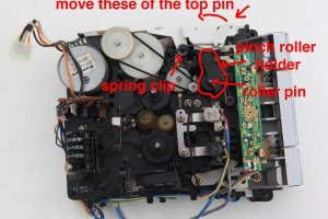

I believe this link will help folks who run into problem with pinch roller replacement.
There is a short cut to change the pinch roller by using a pin and push the steel axle / pin from the pinch roller. I didn't want to do that because you can lose the pin inside the deck and also damage the plastic.
I followed the right way but missed the linking pin for auto stop under the lever. It appeared like it was there but was not there in the right slot.
