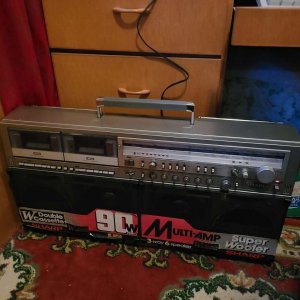

I have an East Asian version of this GF-777, and basically it is working, and the mechanical parts seem good, BUT
1. the speaker volume is relateively lower than when it was new (which was about 35 years ago when I was kid)
2. the volume is EVEN lower when it switchs to play tape, barely audible with volume button turned all the way to the right. I have tried to clean the tape head with pure Alcohol, and it is the same no matterh which tape bay I am using
would appreciate if any input here
thanks
