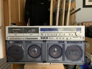

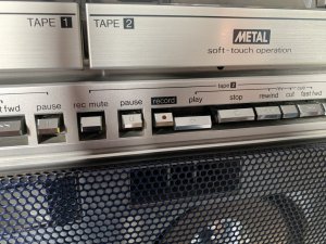

Hi All, please can anyone give some advice with my GF-767
The stop button will not release the play button, any ideas how to fix this issue?
I have had this box for 40 years and first issue I’ve had.
I appreciate any help/advice offered.
Many thanks

Could be a bad belt. You also might have to rotate the flywheel by hand until the heads drop down then the play button should pop back up.

Success.....
Removing the tape deck you can see in the previous post, about 4 screws and gently lifting it to get access to the flywheel. rolling the flywheel backed off the pinch roller and head, then the 'stop' button released the 'play' button.
