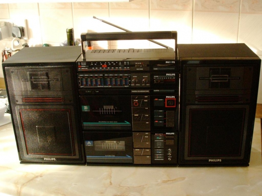

I recently bought a Philips D8778 for only €25 at a second-hand store in top-condition. I'm really happy with it but I would like to take it to places like camping and such. Ofcourse I could always buy 10 pair D-sized batteries but I'm looking for an alternative. I still got a 12v gel batterie from an old security alarm laying around here. So I'm asking you guys if you got any experience with doing this are mayby some other ideas.

It's not an fm radio, It's quite a beast that we're dealing with ;-)
(btw, the image is just from google)
