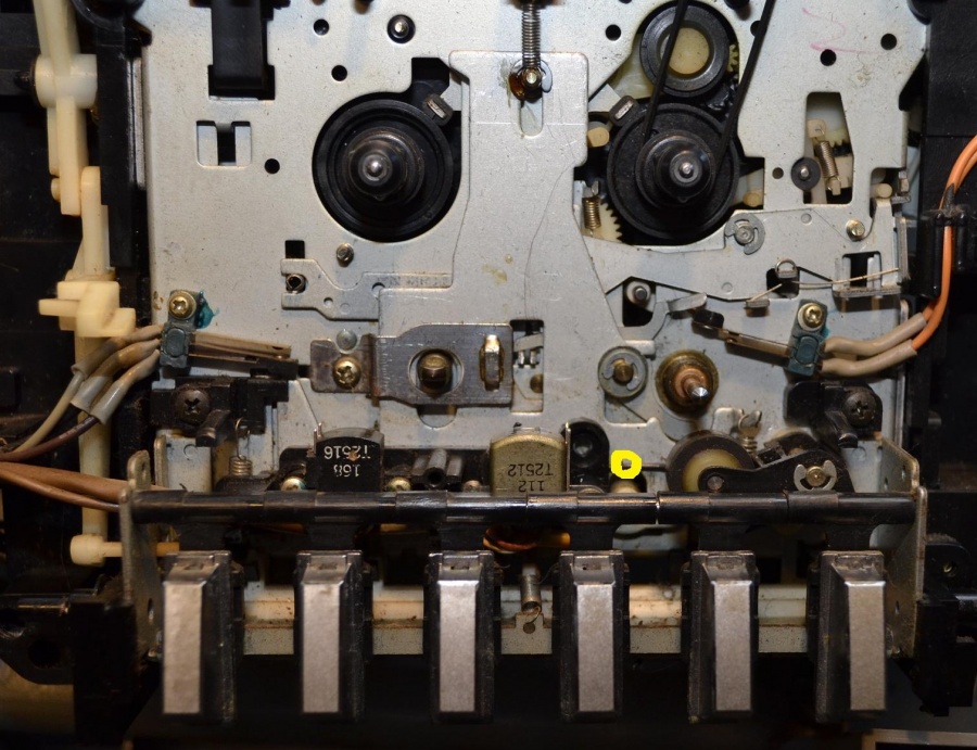

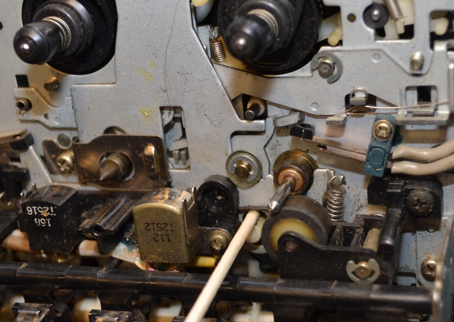

Ok. Let me first just say I can see why no-one wants to tip their hat at the 'fix'. This is a complicated tape deck.
I was able to get the mechanism to lift far enough 'UP' to engage and play without fail by jamming a stick right above where the plastic lift guide goes.
example:
So with that in mind...I'm proposing to JB weld a washer to the back plating in this spot:
Any thoughts guys?

Your picture doesnt have enough light nor the correct angle to see if there is an issue with the spring as is with most that have this problem. Its been a few years since I have worked on these. But if memory serves theres a spring that pushes up (or should be pushing up) on the white round prutrusion that is below the wooden stick in your one pic. Your wooden stick is blocking what i need to see lol. Take a well lighted picture that shows that area clearer and I may be able to tell you what is wrong. When the plastic breaks it is not always very noticable. It can be a hairline crack which allowed the spring to pop into a different position and to the quick eye does not look like a problem. Look closely for a hairline crack in that black plastic where the heads are mounted. It will be on the right side. If I had worked on one a week ago i could be exact but its been too long and too many projects in between to remember specifically.
