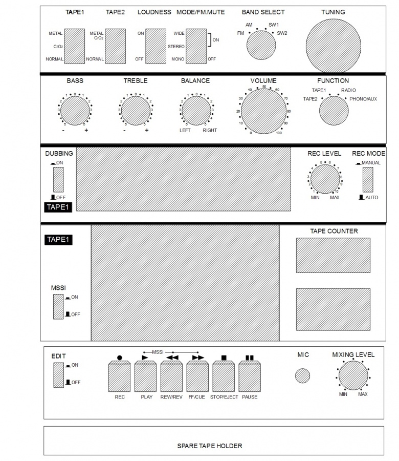

We have been doings lots of technical drawing at university recently and I really enjoy it so today I sat down and thought of how I can use my newly accquired skills ( :lol: ) to do somehting useful for the boombox community.
Well, after 2 hours, this was finished:
I guess it will not appear in scale on here but if you give me your email addrss i can send a PDF version to you. :yes:
Now here is the cool thing:

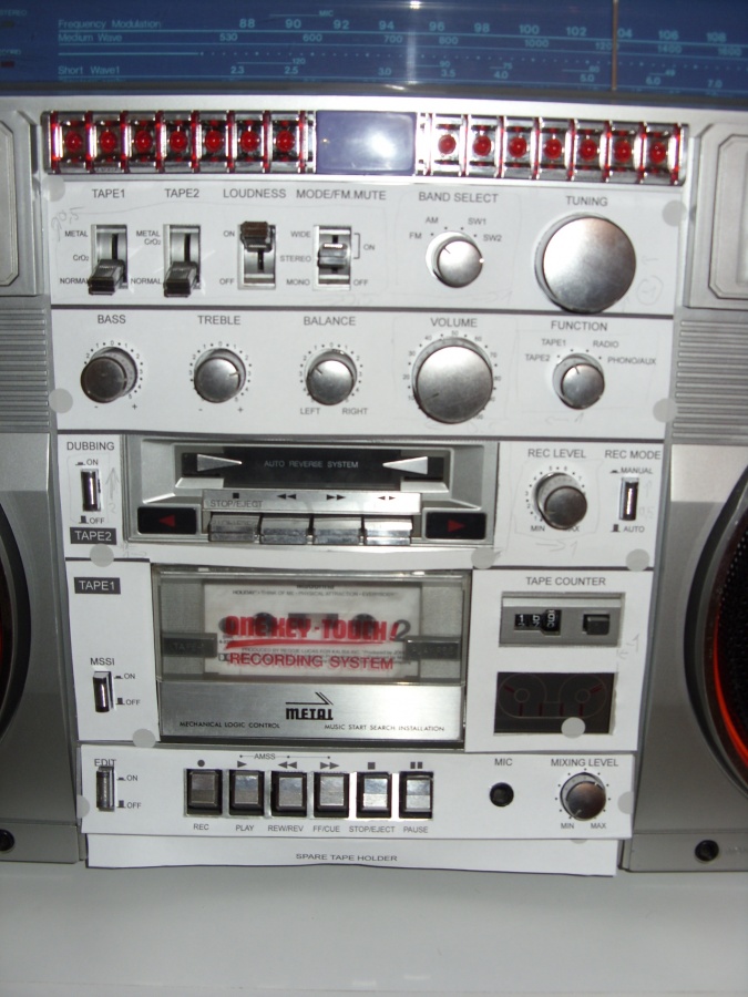

It is 100% on scale and has been overdone a few times to fully fit the original trim. I had a paper cut out put on mine and boy, if it was brushed silver optic, nobody would see any difference.
So here is what you do:
Get this: http://www.d-c-fix-shop.de/metallic-brush-8186.html
Cut it to a size that fits your printer.
Glue it either on thin sheet metal (would not recommend that) or on thick plastic or thick paper (would recommend plastic actually)
Be careful to make the bent side of the cassette key trim come out right...carelly cut the plastic lightly to be able to fold it.
Use double-sided tape to attach it to the box...it will be removable easily again but also holds on tight for quite a while. :yes:
Now you have no excuse to not make your C100s looks beautiful again :-D
I am also working on a full front to print out on this brushed metal sticker stuff. Who knows? Maybe this is the way to go custom without ruining the box permanentaly? :-D

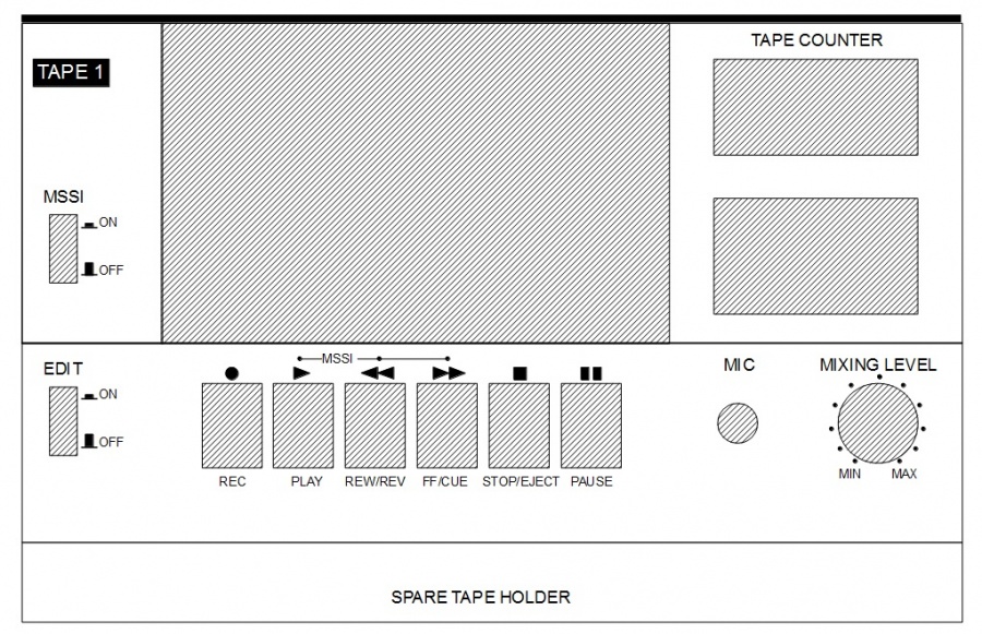

After an additional 4 hours of work, I am done :-D
This version has not been fitted to the conion yet but was measured on the original boombox :yes:
Details can still be changed. PDF ready for you too :thumbsup:

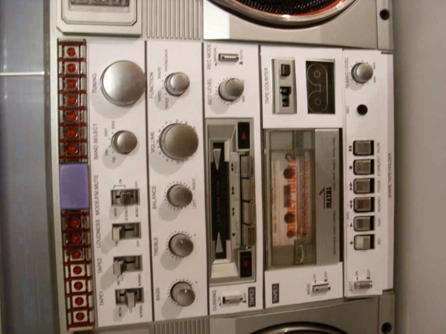

Pics of the fitting:
Adjustments of max. 2mm were still needed but actually I was quite impressed how well it fit. :yes:
