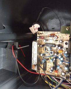

Those small devices will be connected between antenna and antenna connection on PC board. Depending on the version they are “moving down” the received frequency for 14, 16, 18 or 20MHz.
I ordered such a device and built it into my Japanese SHARP QT-88CD. And it really works. With the 16MHz version I can now receive the range from 92…106MHz. This is enough to get all my needed FM stations.
